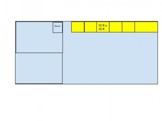

Budget : 2- 2.5 k
Coverage - Radius of 10 meters
The position of the server is indicated, could any one suggest the best location for ideal reception to all the rooms indicated in yellow.
Would the reception be adequate in all the rooms if the modem is placed inside the center room,
or would it be of more use if the modem is placed on the front wall of the center room from the outside ??

This is the layout of the Ground floor

How thick are the room walls in your diagram ? 11 inches or 6 inches or less.
If they are 11 inches, then the room on the extreme left will receive some signal through 2 walls, enough for browsing and email but the big room on the extreme right, looks like a rec area may not get enough signal as the signal has to traverse 3 walls. If the clients are laptops they will be more sensitive than lower powered clients like mobiles or tablets.
Are you able to borrow a router for range finding ? All you need to do is hook it up to the power and see what signal your clients recieve in each room. Does not have to be configured for net its more the signal level that matters. This will give us a better idea. You can use inssider on an android mobile to measure signal level.
