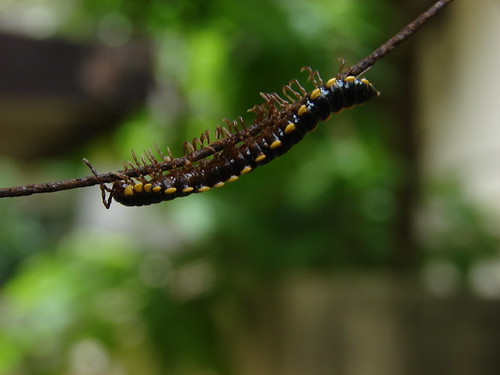

only using a wide aperture wont get u the best bokeh(out of focus area behind the model)
the bokeh depends on a lot of variables such as aperture,distance from lens to subject,distance from subject to background and arrangement of the aperture leaves
hxxp://en.wikipedia.org/wiki/File:Cirles_of_confusion_lens_diagram.png
hxxp://www.kenrockwell.com/tech/bokeh.htm
hxxp://www.bobatkins.com/photography/technical/bokeh.html
EDIT:
U dont need a DSLR to get good bokeh.This pic takes with a Sony H2,5 yr old zoom camera
Flat Backed Millipede by Touzeen Hussain, on Flickr
