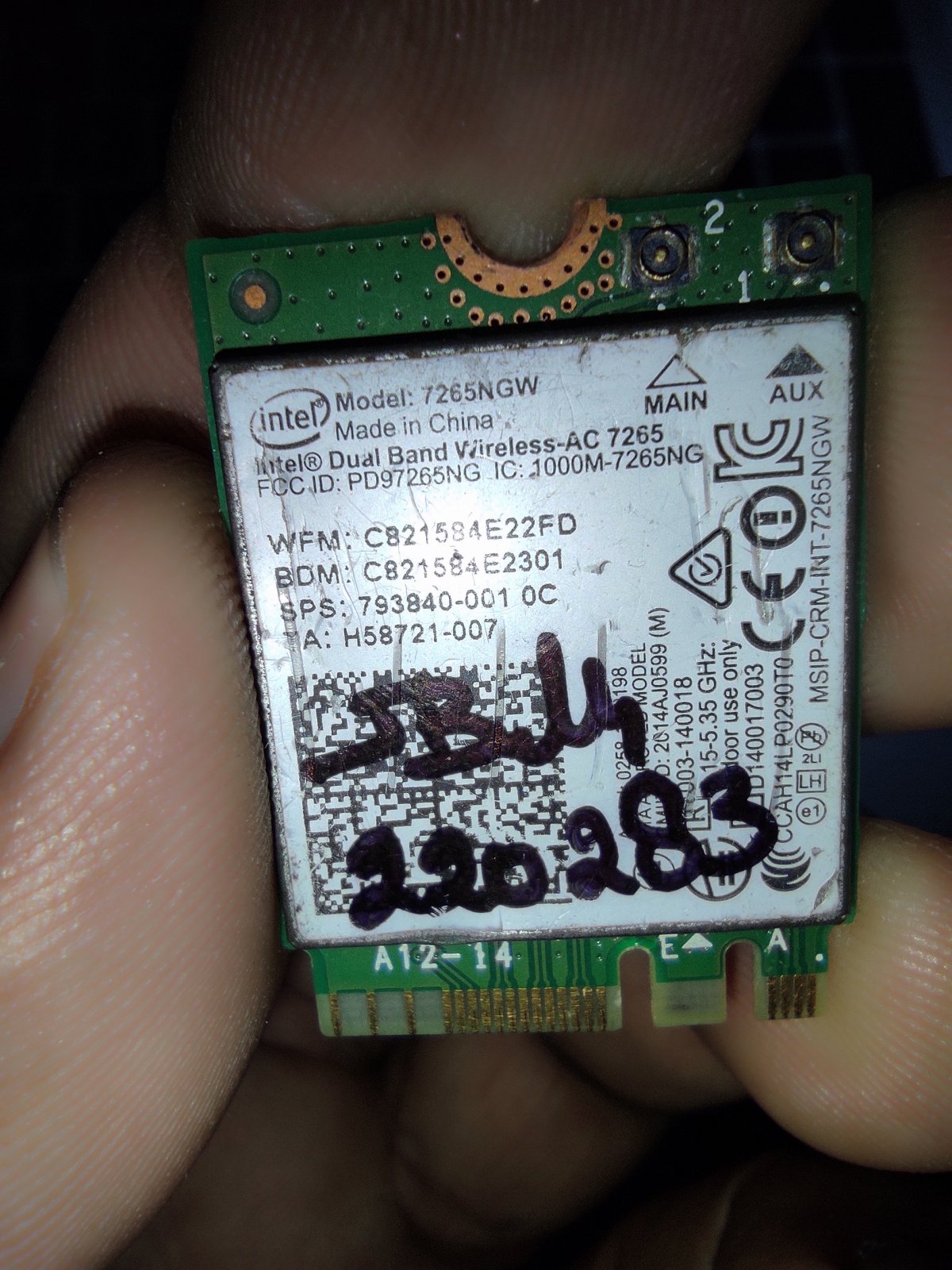

This is the card that fits into the slot. I know that the laptop supports an M.2 card as I am currently using QCA9377. I am asking because I got the card shown in the picture 3 days ago from xfurbrish.com and this is not working. It has some dents and scratches from a screwdriver. I tried to contact them regarding this but they ghosted me. Gone my 800Rs.

That is an A+E key. Not M.2. Check on a Non HP laptop/motherboard if it works.
If yes, then it's HP's BIOS that is the problem. If this is the case, nothing can be done.
Have you tried loading the drivers manually? Does it show up in device manager?
if it shows up in device manager, you need the right drivers. If it doesn't, it's not detected by BIOS.
Is your BIOS showing an error message when booting? Something like WLAN card not detected?

Is this the module the laptop came with? You should post that one for the most accurate advice.

@badwhitevision tried on dell laptop as well. Doesn't work. I am using linux not neet to install drivers separately. But I also tried drivers manually. Nothing works. And no bios error while booting.

If on linux, check if lspci or lsusb show the device, atleast as an unknown device. Or even better, take an ubuntu/debian live install and check if it shows up under network devices.
Linux does need drivers, its just that most of them are already loaded in when the OS is installed. However, Realtek is not very forthcoming with linux drivers, so they might be available on the website but not on the OS itself.

If no BIOS error, then the card itself is not getting detected. So most probably the card itself is faulty, which is also confirmed by the card not working on a Dell board.
Dead card.
If there is a bios whitelist the laptop would refuse to boot with an error (unsupported device or something like that). There are bios mods/hacks to circumvent this. Google your laptop. YMMV.
