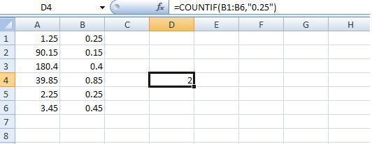

See if COUNTIF along with a check condition to see if the number after the decimal place is equal to what you want to check
To extract digits: Mod(A1,1)
To count cases: Countif(range, "0.15")

You need to first extract the digits,
So, in a Column C, try =Mod(B1,1)
Then try =Countif(C1:C251,"0.05")

I am having similar issues, if the data that countif is searching for are direct values, then it seems to work flawlessly. But when it's a result of a formulae, it seems to have issues.
After some more investigation I think I know what the issue is. When you use MOD(B1,1) to get 0.10, the actual value is 0.999999999999 hence when we use countif, it doens't pick it up. hence the actual formulae should be =Round(Mod(A1,1),2)
I hope I am making sense?
