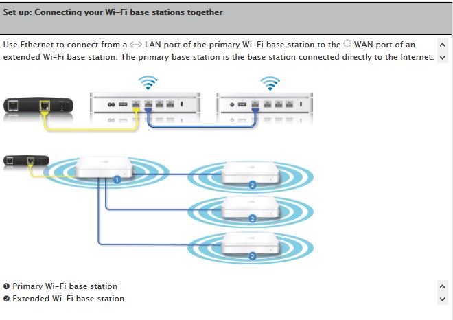

Very specifically - I want to extend my existing wireless network. But i do not want a repeater to use existing wireless signal to further extend. Instead i want my repeater's wan port to get internet connection and transmit wireless connection in my house but not making another seperate network but extending existing connection of my main router.. So that i can move in my entire house with same wifi connection..

i did this exact with airport extreme and express routers.

However attaching a wired AP off the LAN port of router 1 will do what you want. But you will be connecting to the LAN port of router 2 not its WAN port.
here is what i did.[DOUBLEPOST=1365165370][/DOUBLEPOST]http://support.apple.com/kb/HT4260
http://www.officecafe.com/blog/2008/09/extend-wireless-range-with-airport-extreme/

its connected to lan port of main AEBS.
I was referring to the AP's port. All going into the WAN in your diagaram.
Connecting to LAN turns the AP into a switch for wired devices. You are not using those in your present config.
