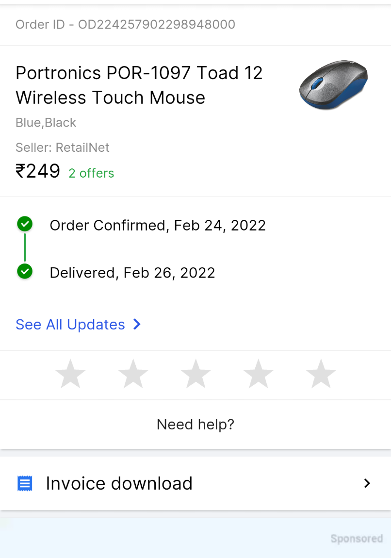

In February 2022, I purchased a portronics toad 12 a pretty cheap mouse and I wasn't expecting anything from it apart from the fact that it's cheap so I won't mind, but it has performed very very well..a bit clicky for the ears but still working great...
They are pretty cheap, the 12 is out of stock and flipkart is selling the toad 13 now..
