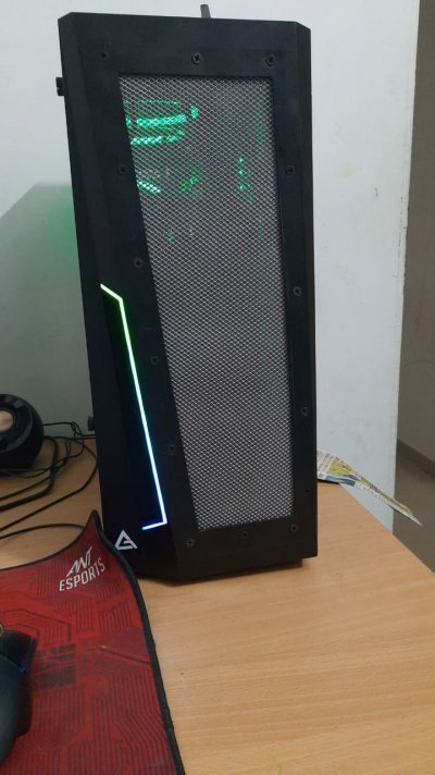

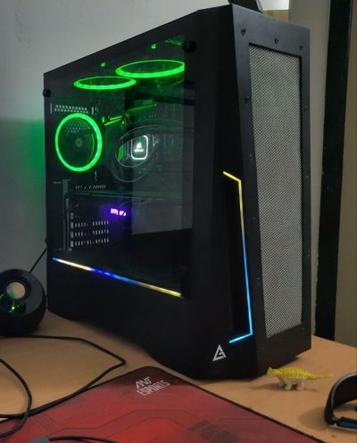

Over heating issue in my GPU Zotac RTX Geforce 2070 Super Extreme AMP any one have idea? i have installed extra fans in exhaust mode, NZXT X73 three fans intake, cabinet Antec dp501 with from cover mesh installed

using since july 2020

I think air flow is good after cutting off the front panel of cabinet i think to replace 120mm fan to 140mm noctua fans (old pic without NZXT x73)
not much of a notice for 120 to 140 shift. I have 3 x 120 and 2 x 140 and the 120 is better as they can suck out air form a patch area faster then that of 140 as it covers larger area. I might not make sense but I can feel hot air removed from my cabinate much faster from 120 mm fans. all are noctua fans !
