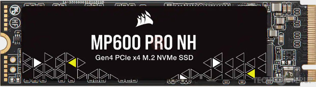

IMO Corsair MP600 Pro NH 2TB at 10.5 + offers looks good even if it is using Toshiba NAND instead of Micron.
