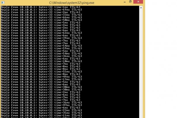

Normally 6ms or 8ms..but sometimes above two digit.i upload an image for current latency.

Coming to my home setup, I have a TP Link 740N as main and TP Link 840N as a repeater. Both are running stock. There are 4-5 devices connected and I am getting ping responses of 1 ms to my router.
Coming to your latency, can you tell me the response on LAN?
