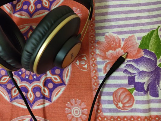

As attached in the pic, one of my sibling's AKG K92 3.5mm end broke due to bending it while removing it from their laptop -_-
Can I simply cut the last few cm of the cable and solder a new aux cable end to it?
Sorry if this comes off as a noob question, I have basic soldering skills but not sure if that would work here, and if fixing this is even worth considering in the first place. Though it still has about 4-5 months warranty left, don't want to go out and get it fixed/replaced for obvious reasons. It's been lying like this since a month, so wanted to see if I can fix it myself. Thanks for reading through.

You need to replace the whole plug and solder the wires to the new plug. Just check which kind of plug the headphone had - TRS or TRRS and you will find a youtube video explaining how to replace one.
Thank you for replying! So if I understand this correctly, if I just replace the plug with another one from, say, an aux cable, it should work as before, right?
Edit: Figured out that it's a TRS connector since no mic or inline controls, plus only 2 circles on the jack
