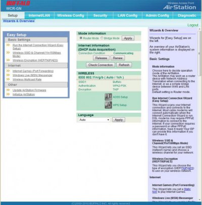

Yup, bought it a couple of months back. Haven't flashed it yet. Still running the stock firmware. Works pretty well for me...
Will post screenshots of the interface in the evening when i get back home.
^Thanks a lot man! That will help. I suppose setting up the router was simple.
OP: Sorry for the thread-jack! :ashamed:
As promised, attached a screenshot. Which other screens do u want me to capture?
