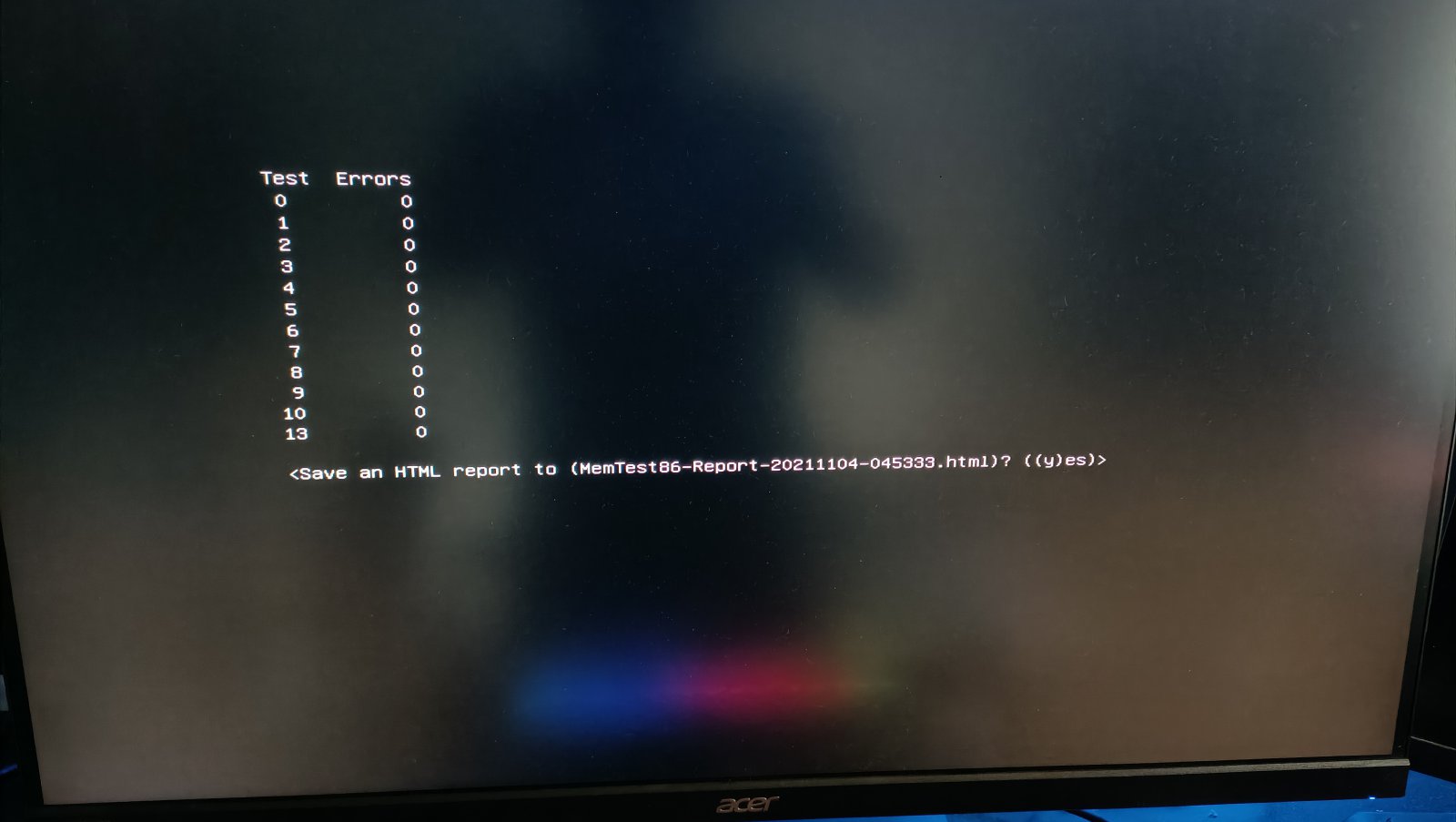

I purchased the 2x16GB Gskill Neo and they are working with my gskill 2x 8GB. So, now I have a total of 48GB RAM and all 4 modules are clocked at 3000 MHz. I had to loosen up the CAS though a little bit, but no big deal. Thanks for all the replies guys... Much appreciated. :)
@kiran6680 ... I ran memtest and it completed after 4 hours. The report says no errors... How do I run memtest over night?
Run it again . No, just kidding, I think you are fine. When CPU and RAM used to be slow and with fewer cores, it used to take longer. Overnight just means that we let it complete, and not have to interrupt it because we have work to be done.
Congrats, your gambit succeeded.
