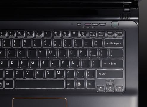

5. Backlit KB is good but I won't need it much as I can touch-type.

5) You can disable it from Vaio Control Centre.
