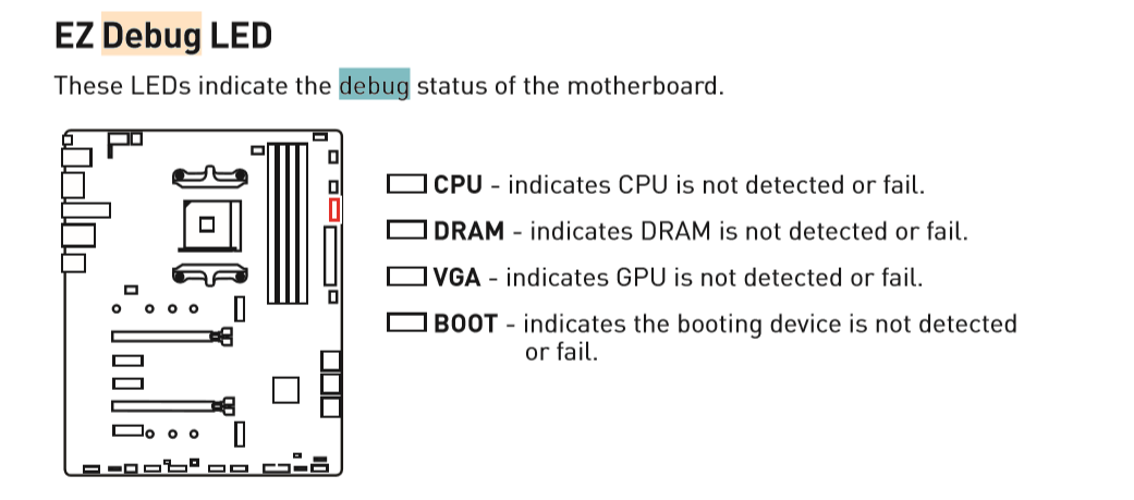

So in my New build i used MSI B450 Gaming Pro Carbon.
Every time when i start it up, the Red Light on the Mobo lights up for about 5 seconds before booting.
The lights are CPU, GPU & Boot in the mentioned order.
My System boots just fine and runs good to. The manual states that the light indicates faulty hardware.
Should i be concerned since on googling the light every tread is about system not starting on seeing the red light, but that is not the case for me as the system boots properly with no error messages or anything.

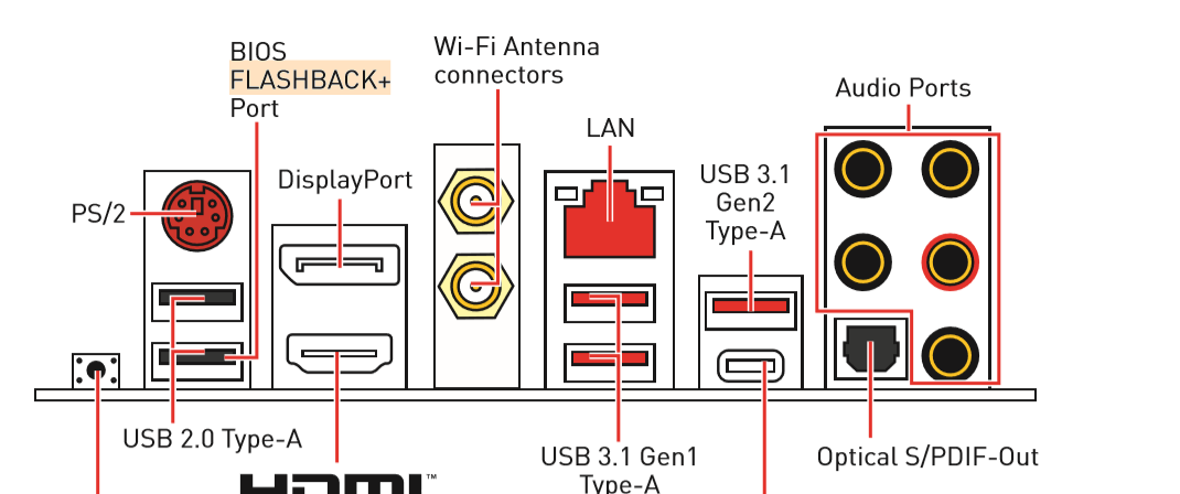

Can you check if any USB peripherals are connected to the BIOS Flashback USB port.
And as for the light I checked the manual and its CPU,RAM,GPU and then boot drive

Connected a USB Mouse & USB Keyboard in the USB 2.0 port. Specifically the mouse is connected in mentioned port
As for the lights, the light is mentioned CPU, GPU & Boot lights up, don't remember seeing the RAM light blink

3 blinks of the Red LED near the BIOS FLASHBACK+ button is normal.
Debug LEDs are there to troubleshoot Boot problems due to hardware failure or missing hardware. If your system boots normally then ignore them. My previous Motherboard Gigabyte X370 Gaming K7 also used to cycle between different Post Codes before booting. This motherboard does not have Post code so Debug LEDs simulate the same behavior.
My Mouse is also connected to the BIOS FLASHBACK+ USB Port. It does not make any difference even if I leave that Port alone and connect the Mouse to a different Port. This slow POST could be related to earlier BIOS version. Update the BIOS to latest version and check.

I first removed the mouse from the flashback port, the blinks reduced to 15 sec.
I reconnected them to the flashback port the blink is still at 15 Secs.

So the Flashback port didn't seem to have anything to do with it.

Yes, the BIOS FLASHBACK+ Port should not make any difference.
BIOS update instructions are provided in the Manual. You can use the M-FLASH method. Do not updated BIOS from the windows utility.

It's the GPU light that stays on the longest.
Yes, the VGA light stays on the longest and last to go off and this is normal. The abnormal behavior is if the light stays on and does not go off, in that case it indicates faulty hardware or hardware not connected and the Computer won't boot.
